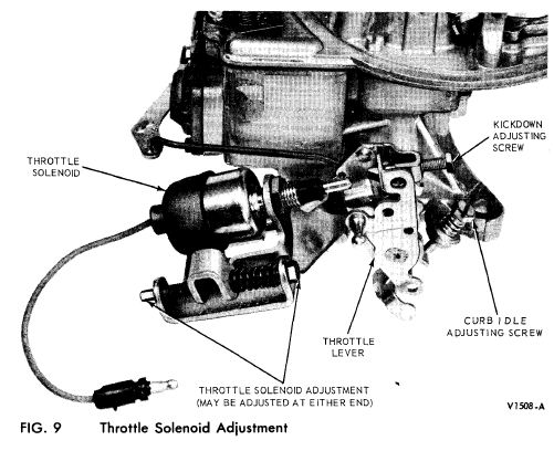

Verfasst: Do 4. Jul 2013, 12:56
von TomTorino
Ist nicht gebastelt.
Nennt sich Throttle Solenoid.
Leider ist mein Englisch nicht so prickelnd gut, dass ich hier eine Funktionsbeschreibung abgeben kann.
Aber hier ist doch sicher jemand, der sich da auskennnt...

Merci für das Foto, hab gestern schon einen in eBay.com gefunden:
http://www.ebay.com/itm/1968-72-Ford-Me ... a1&vxp=mtr
Aber ich hab noch immer keinen Plan, was das Ding macht? :)

von Bibabutzemann
Ausm corvette forum... lagst also gar nicht falsch
The solenoid on the carb that when energized bumps the accerator lever, is commonly called the idle stop solenoid.In early years this solenoid is energized whenever the ignition is on. It is deenergized when the ignition is turned off, and is used to stop engine desieling.In later years, it was tied to the A/C system, and was also used to bump up the idle speed when the A/C compressor was running - I believe this was to help with engine cooling when idleing.In 71, there was a 1 year only CEC system. The CEC (Combined Emissions Control system) solenoid replaced both the TCS solenoid (used in 70 and 72), and the idle stop solenoid. More info can be found here - start on page 5. http://ncrsrmc.org/Downloads/Mar-2006-Newsletter.pdfTo know exactly how it was used in 74, I believe you will need to either look in a 74 service manual, or find out from someone with a correctly functioning 74.
